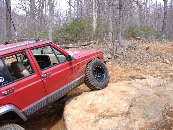

I NEEDED an SYE when I liftewd to 4.5"!!! There was no doubt about it!
The transfer case drop didn't do the trick (this pic still shows it installed but it has since been removed).
Running 32's.
1992 XJ Laredo
RE6130 4.5" XJ Super-Flex Kit
RE1801 Slip Yoke Eliminator Kit NP231

jppilot61.... do you have any clearance issues at full articulation??? Are they 33's??

I trimmed (CUT) right at original line on outside of fender flares.
I then trimmed straight across at front for cosmetic appeal.
I have NOT rubbed these 32's at all.
This is about as severe as I anticpicate, and while passenger side was stuffed up pretty good, I didn't notice any rubbing.
