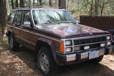

Thanks for the reply, noticed you have/had an 88 limited. Love mine.
