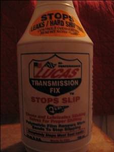

I would change the fluid again, maybe even flush it if the pan is filled with gunk again when dropped. Just run it for a couple days and get new filter and fluid. I like to add a bottle of Lucas in the tranny, it works great!!!

Why do you need a new valve body? Just change the bogus Governor Pressure Sensor and Solenoid. As for Lucus trans treatment, a friend of mine wasted his trans with that stuff. It works good on mechanically actuated trannys, but is too thick for solenoid actuated trannys. The "best" stuff the use as far as tranny treatments go is LubeGard. It doesn't hurt the trans or the electronics, it simply removes the varnish from the clutch packs, steels and valve body without damaging anything. I brought a 2spd Ford-O-Matic, and a TH350 back to life with LubeGard. It's works great.
Well I would guess that you're assuming the Lucas "wasted" the tranny. How would you know that it was definitely the cause? The tranny was probably on its last leg, and I would guess that's why he was adding the Lucas. No treatment out there can restore a dying tranny, that's about to quit. I've used Lucas in many different vehicles from Cadillacs, to Mercedes, to JEEPS. All with same results. It did what it said it would and worked great. I wouldn't be able to call Lucas the "best" stuff to use as far as tranny treatments go, because I haven't tried every brand on the market. That would be ridiculous if I did. I can suggest it to be considered an option.
Hey, we're all entitled to different opinions. That's what forums are good for. Mr. Green
I would do what Tardis says and change the solenoid and sensor. If that's what the codes are throwing at you, then that's what you should address. Cool
Actually his trans worked fine before he put the Lucas trans treatment in. The truck had about 75K on it when he did it. We told him not to put the Lucas treatment in, and he did anyway and wasted the 1st-2nd and O/D solenoids in his trans. It really is too thick. I don't have anything against Lucas products. My friend runs Lucas engine oil treatment in his vehicles with no problems. The stuff works good.
LubeGard "is" the best trans treatment. I've heard this from evey mechanic I know. The stuff works great. A friend of mine that rebuilds trannys for a living turned me onto it about 10 years ago when I had 2nd to 3rd shift problems with my Chevy Impala's TH350. I poored a bottle of that stuff in and within 1hr is shifted like a dream. I never had a trans problem in that car again.
