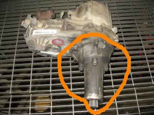

PostPosted: Sun May 13, 2007 8:48 am    Post subject: tailhousing to long? Reply with quote
Hi OrangeMC13,
Regarding your observations of the pic of the 231 hd transfer case I was looking at. I spoke to the gentleman again about tailhousing length. He has another tailhousing and shaft off a Wagoneer that fits a 231. At this point, unless someone sees a problem, I will still pick this item up and do the swap (or at least attempt it)?
Terry

Shocked WOW Shocked that tail shaft is huge!!

ďthat tail shaft is huge!!Ē
Came stock on a 98 Durango.

PostPosted: Sun May 13, 2007 2:28 pm    Post subject: Will it still be HD? Reply with quote
One more question (at least for now) for the ďexpertsĒ. On this case pictured, I have to swap in my input shaft, as well as remove this 32 spline tail shaft and housing, and install a 27 spline. In doing this, will I be in essence, eliminating the ďheavy dutyĒ rating from this 231hd. If so, I know of another 231 for half the price that is somewhat rebuilt.
Terry

i dont think so, i know one of the things that makes an HD a HD is that it has a wider chain then the standard 231. ill check around some T-case theads and c.
PostPosted: Tue May 15, 2007 6:42 am    Post subject: Reply with quote
Terry, it is a wider chain that that makes it a HD. I would just look for a 231 out of a Cherokee and it will be a lot easier to install. If your lucky you won't have to swap anything and it will bolt right up. If not, you'll only have to swap the input gear.
If you're gonna change the shaft and tailhousing on the 231 HD, you might as well get a SYE and do it right the first time.
If you've never opened a T-case before, take the easier route, look for an XJ t-case!
