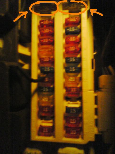

i got my XJ used and it didnt come with a owners manual, now my problem is that my cig lighter and 12V output dont have any power and i used a test light in the fuse box and it did help soooooo if anyone has an owners manual can someone scan or give me link so i know what fuses do what...

Check the bundle of wires that runs into the door from the Jeep. I had that problem and it ended up being the speaker wire was broke inside the bundle. On my 99 the fuses for the cig lighter and the power outlet are in location 1 & 2 they are tan 25 amp fuses.
