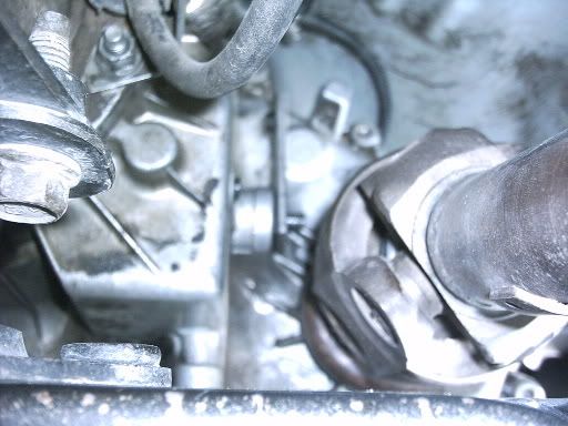

its a 93.. i got it to be in 2 wheel and the shifter correct but i can only go back to clicks in to 4 all time and then the lever hits the tcase preventing it from going to 4 low.. so i guess im gonna have to use the lever from my 249 since it is ofset.. i may need to trim it tho.. we shall see.. how wierd tho everyone ive heard of doing the swap used the 242 lever......

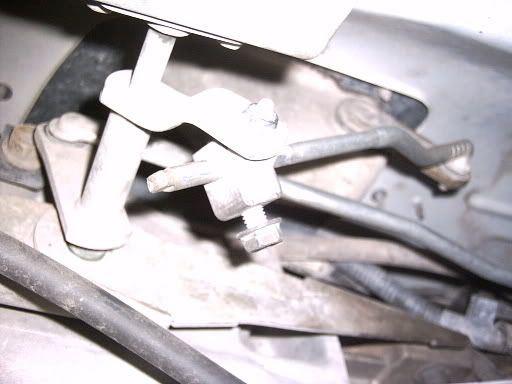

Did you take the 242 lever off??? Are you sure you have the linkage on the right side of the lever? it could pop in from either side..
PostPosted: Sat Aug 18, 2007 3:43 pm    Post subject: Reply with quote
Here is the linkage as it connects to the t case..(This is a 231)
And this a picture of the linkage cross section you can see the T case stick on the left and the cross over on the right..
Hope that helps..

ok well my lever is like that but instead of it being exactly like that it is a little lower in 2... so when i shift it it goes closer to the case and in 4alltime it hits the case preventing it from going back to 4 low..... i think its some how messed up.... should i post pics or what?

OK the problem is that when the tcase is in four low i cant connect the linkage at all.
Is the 242 tab suppose to be off set at all like the 249?

DankNesS
Joined: 14 Oct 2006
Location: New Mexico
PostPosted: Tue Sep 04, 2007 3:33 pm    Post subject: Reply with quote
the first pic is of what it looks like when if the tab is pointing up.. with this the shifter will not move cus it is pushing the tab instead of pulling it. when i have it like your pic the tab down it hits the case when shifting it into 4alltime. it wont stay in all time and causes grinding since it isnt all the way in. i think a tab with a notch a lil offset similar to the 249 is what i need. is there differant tabs available for the 242? maybe i have the wrong one? or does my linkage look wrong?

PostPosted: Wed Sep 05, 2007 3:19 pm    Post subject: Reply with quote
this is the only way i can get the tab on the case in 4low.. see how its backwards from yours? u can see if i flipped the tab it would be going into the tcase thats why i have a problem with it being flipped cus i can only get fully into 2wheel and part time as shown here

PostPosted: Wed Sep 05, 2007 6:27 pm    Post subject: Reply with quote
This is the right way ... But if you need to bend it or modify it and make it work go for it..
What I would do is go to a bone yard and snatch one off of another 242 and see if its different...If so try it out..
