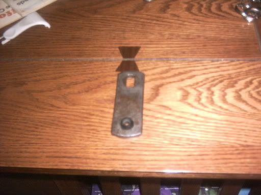

its straight up and down no offset. the 249 tab is too long and the offset is either the wrong way or too much.
is the 242 tab suppose to have an of set? is there a chance i have a 231 tab? i sure hope that is it cus im sick and tired of having to jump under my jeep to switch it to 4wheel that shiot gets old real quick!

well ive cut my tab and had it welded didnt work the first time cus the spot weld broke Sad
SO i got it welded with a good bead on both sides and good penetration.
and it was a MM off. barely barely wouldnt go on in 2 wheel all other gears are fine.. SO ive cut it again and am going to attempt to get it welded for the 3rd and hopefully last time
can anyone tell me from my pic if i had the right tab to begin with
RE,adj tb,cold air,str8 pipe to flowmaster,242,boredTBwspacer, msdboxwirescoilpump,moparpcm, Efan,5.9alte,sytem2sick,tirerack,oba
View user's profile Send private message Yahoo Messenger
PostPosted: Wed Sep 26, 2007 5:46 pm    Post subject: Reply with quote
Looks to me like you have the wrong tab. The t-case hole on yours is straight like my 231. The 242 is slanted a bit. Also the length is off, 249 is longest, next is 231, and shortest is 242. Look at Swampy's pic from his 242 swap, the 242 is on the gound, 249 on the case. Your tab is definitely neither of those. I think you're working with a 231 tab!

AWWW HA!!! just what ive suspected! what a great relief!! to bad i didnt put 2 and 2 together back on page one!! ha ha! i pulled the tcase and rebuilt for nothing other then practice! what a riot. i cant believe i didnt think i might have the wrong tab from the get go! damn i wonder why the num nuts i got it from gave me a 231 tab. if i cant get this one welded soon i guess ill call all the junk yards and go check the u pull again. thanks for the pic... ive looked at the write up a doxen times i dunno why i didnt think of it being the wrong one sooner. thanks for all the help everyone

hit up the upull and got the correct tab! ya for me! only took a few months to figure out i had the wrong one and had put the case together perfectly fine the first time. LIVE and LEARN. here is a prime example
