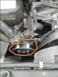

While we're at it, where is the water pump located? 4.0 ltr engine.

And the water pump! Mr. Green
