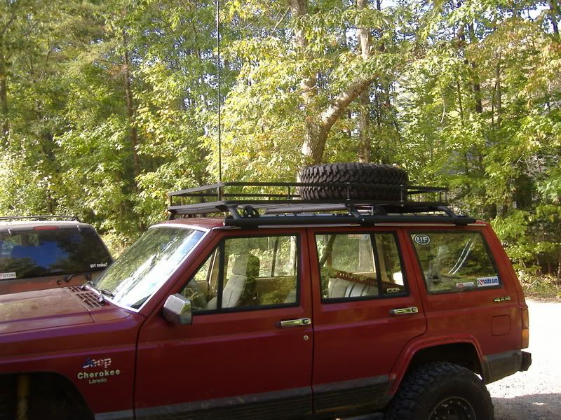

PostPosted: Wed Oct 03, 2007 12:54 pm    Post subject: New Olympic Top Hat Roof Rack Reply with quote
I managed to put it on last night and another hour today. Will hold my spare a bit better than redneck engineering job before with piece of plywood and a severely bent in roof!
Hope my bushing in my driver side LCA holds up.
I need to do a lot of suff on front end when we get back! Keeping my fingers crossed!
