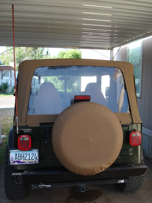

thank you for all the ideas/replys i found my old 4' fiberglass antenna in my shed that i had on my old CB, i bought the teraflex drivers side taillight mount and installed that, it didnt come with an RF ground but i did ground it DC wise... i dont have an external SWR meter but the CB has a SWR adjustment and a tuning setting from what i can tell, i dont know alot about CBs but i think i got it somewhat where the SWR should be, but when i turn on the CB to transmit/receive no matter what the squelch is at i dont get any sound, i dont know if im transmitting and not receiving or if its not doing either, i live next to a busy freeway and try radio checks on the trucker channel and never get a reply... am i doing something wrong? i know im kindof vague but i dont know very much about this lol
thanks!
The behind tail light mounts are great but usually require a little more to properly RF ground. Chances are good you aren't hearing anything because of one (or several) of the following reasons:
1.) Bad RF ground (like I said, it's NOT the same as a DC ground)
2.) Bad antenna (broken internal wire)
3.) Bad coax
4.) Improperly installed stud assembly
5.) All of the above
Merely an out of tune antenna you'd still hear stuff because the antenna is likely resonant (or close to it). And I wouldn't trust an internal CB radio (including exports) SWR meter. Sometimes the S-meter itself won't even forward calibrate properly. So if you can't get it to forward calibrate, that is a good indication of a dead short, open circuit, and/or bad S-meter.
Post some close up pics of the mount/stud assembly, and we can tell you if it's installed properly.

so i dont need a DC ground at all? how do i get an RF ground? just buy an RF ground cable im gonna guess yes? lol heres some pics:

Welp...here's at least the majority of your problem.
Right now you have a dead short. If that is an insulator it's trashed...replace it and don't tighten it down so far. It looks like a lock washer in the pic here though. You can pick up the insulator/isolators from Radio shack or any truck stop for a few bucks.
Here's what the set up you have should look like (notice the plastic/nylon insulator):
The spring you have on here is a light duty spring too...be prepared for it to flop all over the place. It's better than no spring...but I'd probably suggest switching it over to a heavier duty spring eventually. The ground strap you have off the SO-239/PL-259 (coax) connection should be alright provided it leads to a "shiney metal" point. I prefer doing a self tapping screw myself at the ground (counterpoise) point for a quality RF ground. I don't use the type connections on a mobile like you've chosen...but the same end result should happen. Here's an image of my ball mount that should give you the gist of what should occur...no matter what type of stud assembly you have. The only exception would be a "no ground plane antenna" (which don't perform well).
The center lead is insulated from the vehicle, and the ground (shield) is your ground (counterpoise). Shiney metal is your friend on an RF ground.
Let us know how it goes.
