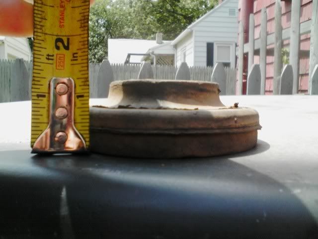

You'll get 3/4" with one of these. Simply stick it between the poly spacer and the isolator already there. You can get them brand new for cheap from a dealership or score some from a junkyard. These are commonly used to get a little height in the front when leveling or adding weight with armor or winch.

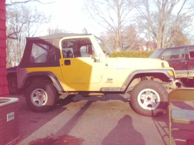

I did this lift in the spring. He had the same worries as you, that the front was too low and it wouldn't look good. This is a 2000 with 2" coil spacers only. We didn't end up adding in the extra height because it looked fine.
Before w/235/75 15
After w/31x10.50 15

That is a good idea Orange, and cheap too. The only problem with getting the spacers you have pictured is, I have yet to see a TJ Wrangler in any of the junk yards in my area, plenty of Cherokee's though. I wonder if they would be the same?

PostPosted: Tue Jun 24, 2008 6:38 pm    Post subject: Reply with quote
They are the same
PostPosted: Tue Jun 24, 2008 7:07 pm    Post subject: Reply with quote
You could also get them from a ZJ. The one in the picture is from an XJ.

EXCELLENT!!! I figured they would, but I wasn’t a 100% sure they same diameter spring up front.
