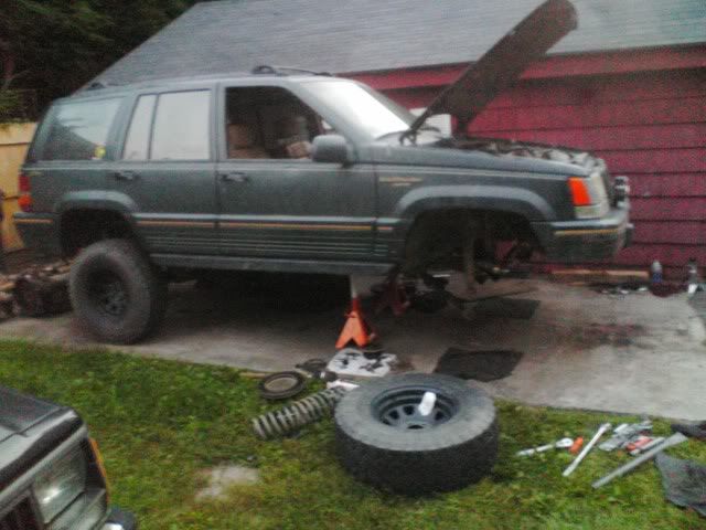

The LP D30 in my ZJ has a bad hub assembly, pinion bearings, pinion seal, and axle seals. I've also been getting vibrations because of the pinion angle (which caused the bearing problem), since it's been lifted to 4.5". So, I've been searching for a replacement. As hard as it is to find a HP D30 w/3.73's, I found one! Someone local had one regeared at a very reputable shop around here. The tranny went in his ZJ and he decided to part the Jeep. I snatched up the front axle right away. Mr. Green I also got some adjustable upper control arms from the same Jeep, to help with the pinion angle.
PostPosted: Fri Sep 11, 2009 11:24 am    Post subject: Reply with quote
It's raining out right now, but I'm heading out to see if I can get it all buttoned up. The axle is under the Jeep with control arms, coils, shocks, driveshaft, and track bar attached. Just gotta install the shafts, hubs, brakes, steering, breather hose, disco's, and tires. Then lower it down, tighten everything up and fill the diff!
