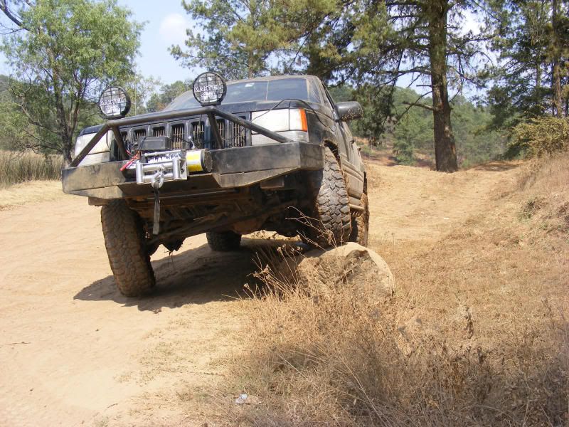

Cool, thank you very much. I don't have stock front bumper, I made one.
Could you be so kind and show me a picture on what are you talking about on the flares? I don't mind trimming the fenders.
SYE ? on a 249 are you serious?
BTW: Let me show you my rig.
